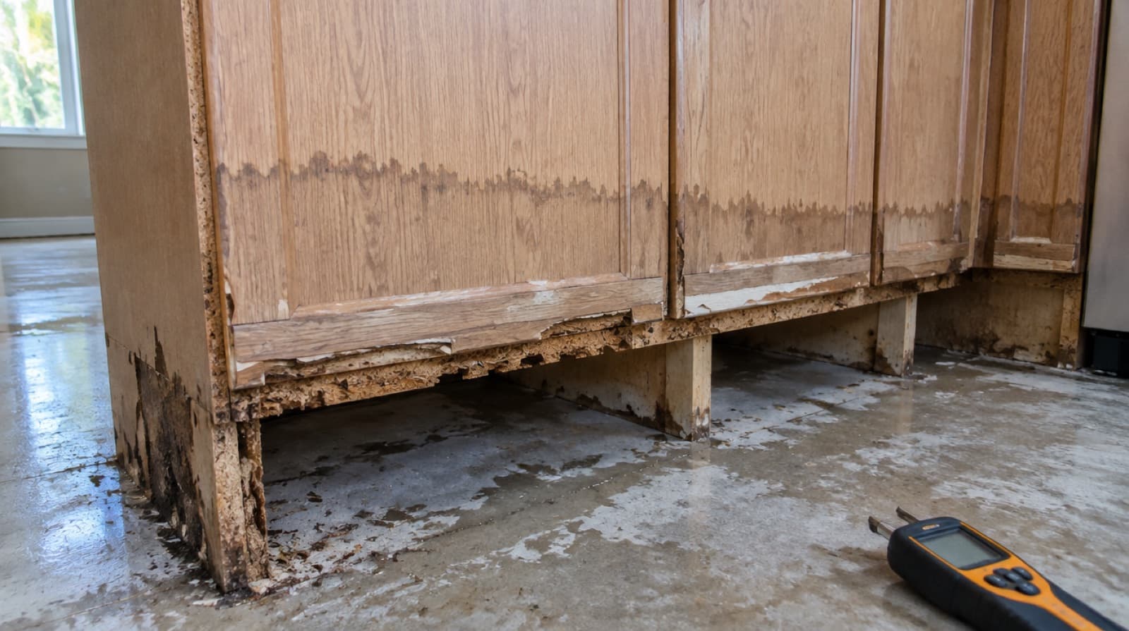

Open the sink base and look at a cut edge on the bottom or a side panel. Plywood shows thin layers of wood glued together. Particle board looks like pressed wood chips, and MDF looks like dense cardboard. FEMA's flood repair guide lists particle board and fiberboard among materials that fall apart when wet, and notes that solid wood can usually be cleaned and repaired while wood veneer often separates and warps.
If the boxes are sound and only the finish is ruined, see what cabinet refinishing costs in Miami. The sink base usually fails first, since it may already have had small leaks before the flood. Look for swollen bottom edges, a soft floor panel, laminate peeling at the seams and doors that no longer close flat.

The cabinet box is only half the problem. Behind it is drywall that soaked up water like the rest of the room, and under it is a toe kick space that holds wet dirt against the slab. If the lower cabinets stay in place, that wall cannot get a proper flood cut and dry out, and mold grows where nobody will see it.
So lower cabinets are often removed carefully, labeled and set aside while the wall and slab dry, then reinstalled. Whether that works depends on the countertop. A stone top can make removal impractical, and then the drying has to happen through the back and the toe kick. We decide that at the walkthrough, not over the phone.

Sometimes. If the boxes are plywood or solid wood, read dry after a few days, and only the doors, drawer fronts or toe kick swelled, replacing those parts is a real option. MDF doors that swelled at the bottom edge do not shrink back, but new doors can be made to match, or the whole kitchen can get new doors and a fresh finish at the same time, which often costs less than new cabinets. That is the same work we do in cabinet refinishing, and our guide to refacing versus replacing walks through the choice. It is not an option when the box itself is particle board and the bottom panel or sides have swelled or gone soft, because that is the structure holding up the countertop. And it never makes sense before the wall behind the cabinets has been opened and dried, because new doors on a wet base just move the mold problem a few inches back.
